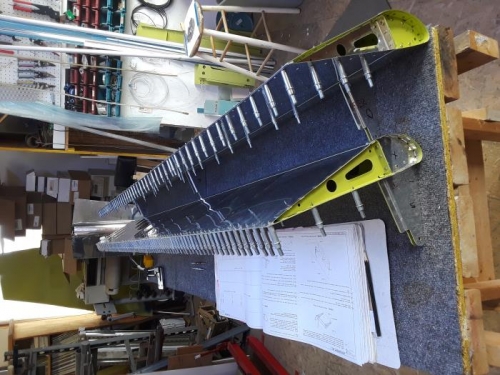

This is the last piece of the structure I have to assemble. ( excepting closing the wing bottom skin) While the left flap trailing edge is curing, I am moving ahead with the right flap.
Same routine as the left flap excepting a mirror image of same. Peel the blue plastic, deburr the edges, assemble, preassemble the hinge brackets, assemble the frame, final drill the frame, add the skins, drill..... then take it all apart.
Countersink, deburr the holes, then prime. Once the primer dries, everything is ready to assemble and final rivet.
right and left flaps on the table
