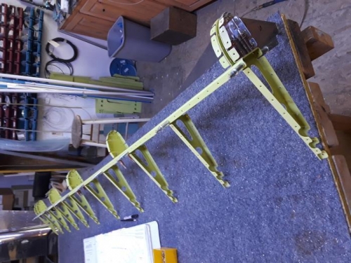

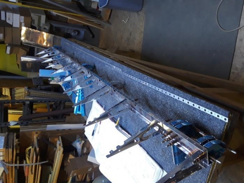

Brief Description:  Left flap
Preassembly of the flap went quickly. Lots of cleco moving in order to match drill all of the holes.
I then disassembled and began the process of countersinking, deburring, dimpling and priming all of the parts.
Countersinking, deburr and priming is complete.
Riveting of the flap hinge assemblies, and assembly and riveting of the skeleton is complete
Top skin and leading edges are final riveted, bottom skin forward line of rivets is complete.
The trailing edge is coated with a thin film of proseal and clecoed in place. The flap is weighted and placed on a flat table edge to cure prior to final double flush riveting.
Ribs and spar
Ribs and spar
primed for final assembly
