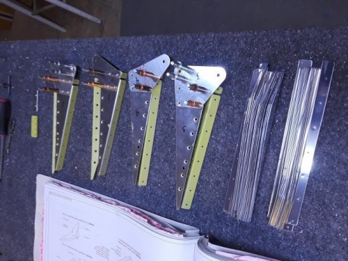

preassemblies of end ribs

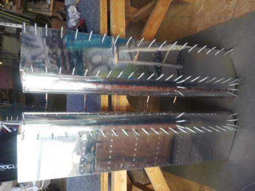

pre assemblies of aileron skins
ready for final disassembly, deburr, prim and reassembly
