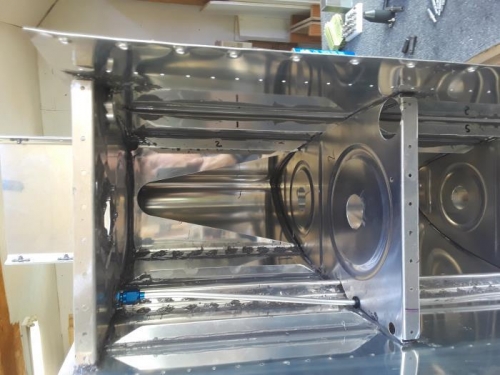

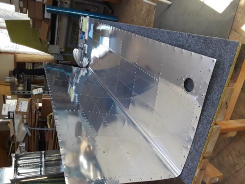

Working with Pro-seal has turned out to be slower and messy, but really not so bad. First the stiffeners go on, which is rather easy on the flat sheet. I buttered the back of the stiffener with pro-seal and placed them on the skin pressing until an ooze of sealant came out of the rivet holes in the skin. Using a pick to align the pieces, a few clecos (I always use the same few and clean with a paper towel after each use) and then back rivet. Clean the show side with acetone and paper towels, then go back with a cut down tongue depressor (cut in width to about 1/8" wide) and fillet the edges and cover the shop heads of the rivets with sealant. That way every rivet is bedded in sealant (the squeeze out) and sealed on the shop side. It took about 7-8 grams of sealant per stiffener.

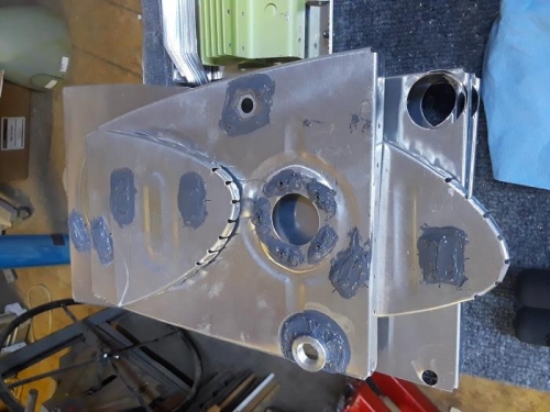

I found a routine on the ribs after a few were installed. Similar to the stiffeners. Butter the edges just thick enough to cover the dimples, insert and cleco. I had to pull the part from the cradle and stand on end to get to the first 3 nose rivets then back into the cradle to finish the rivet line. All done with my swivel head flush set and tungsten bar. With the Pro-seal ooze out, I inserted all of the rivets at once (excepting clecoed holes) and pressed them in with an awl point. The sealant held them in place as I set them up the line. Clecos out and wiped off, place and set the balance of the rivets. Clean the outside with acetone and paper towels, tool the inside with the stick making sure the edges a
dimpling the tank skin
pre-assembly of the ribs with sealant
assembling the tank with sealant
