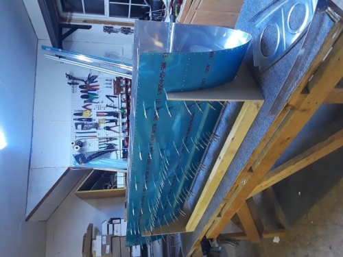

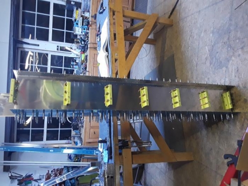

Assembly of the tanks is typical with cutting apart stiffeners and z mounts. I used the table saw with a carbide blade and was able to make quick work and very clean cuts. Then deburring of the various parts. Cleco together and match drill. Not much priming as the inside of the tanks will get no primer.
Initial assembly of the left fuel tank is complete. The right tank is finished up to the rear baffle and Z brackets. Once they are both together, they come apart to be deburred and dimpled
