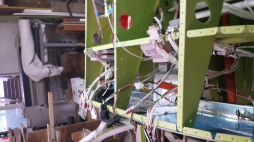

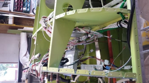

Brief Description:  integrating the harness into the aircraft
Completed all shield terminations and connectors that could be installed prior to installing in the airplane. The connectors for items behind the baggage compartment will wait until after the wire harness has been pulled through the conduit. All in all, the harness fits well. Much to do to tie off all of the various wire extensions.
I started the integration of the wire harness into the aircraft by terminating the Push to Talk and Auto Pilot off wires to the control sticks. I also routed the audio headset wire bundle into the tunnel. As a diversion from wiring, and to confirm my wire routing would not interfere, I installed the heater scat tubing. What a pain to get to the front connections. The audio headset plugs will be installed in the center console.
main trunk supported

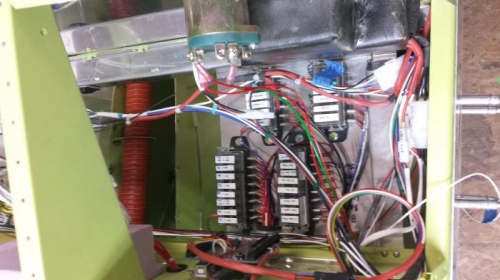

power leads to fuse blocks
