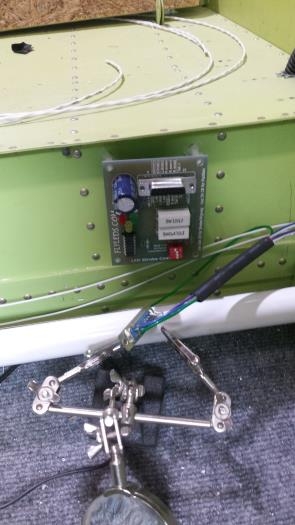

Brief Description:  Fly LED controler mounting and wiring
I ran wires to connect the FLY LED control board to the various lights.
Strobe, position and wig wag each need switched power and a common ground.
Each wing gets a three wire + shield and the tail strobe twires + shield. A total of 15 wires.
The board is installed by the left flap torque tube as noted before.
Everything completed and tested. Rudder trim works, even moves in the correct direction, Strobes, nav and tail beacon all work as intended. It's good to see some of these systems comming together and functioning.
Fly LED controler
Fly LED controler
