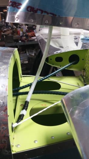

I ran the wiring for the tail strobe forward to the control board. The board is mounted under the flap torque tube cover of the left rear seat.

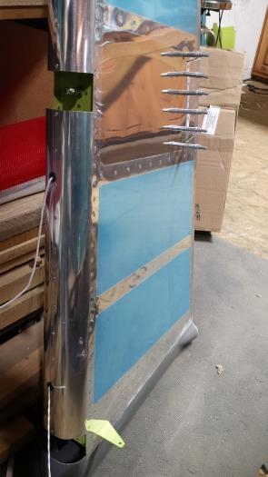

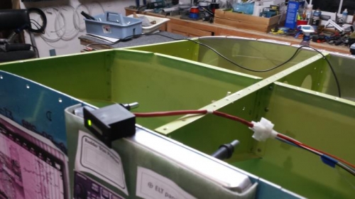

I also ran the wiring to the rudder trim. 5 wires come forward from the rudder. Two split off at the control grip terminal strips. The other three go forward to the trim position indicator. The trim indicator adds three more for power and system ground. That is a lot of wires and connectors.
Power wires to the fin beacon installed.
This should be all of the wires that go to the back completed.
positin indicator
positin indicator

into the rudder for trim and strobe
