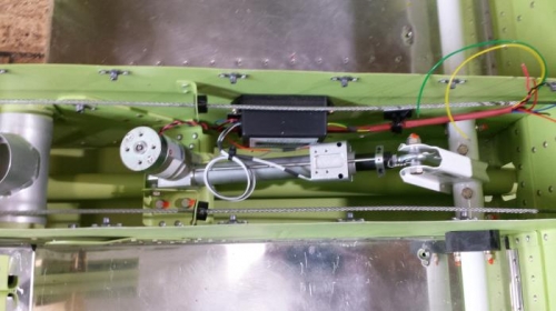

acuator installed
acuator installed

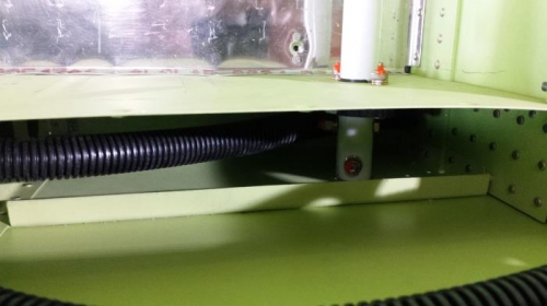

thght fit to get at bolts
