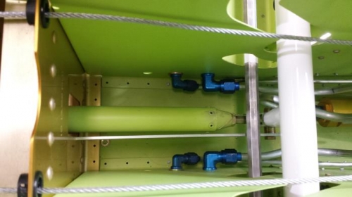

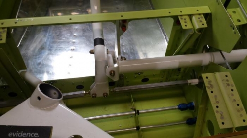

A few more pics of the control set up.
I do have one interferance in the system. The front of the elevator push rod rubs on the fuel line as currently configured. The fuel line drops straight down out of the valve. I already have a 90 degree fitting to reroute the fuel line. I catch that task at a later date.
left control stick bottom
control stick joiner rod

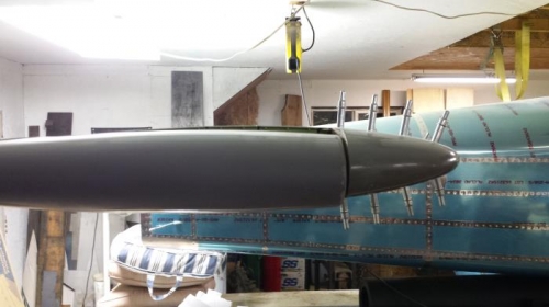

setting neutral position
