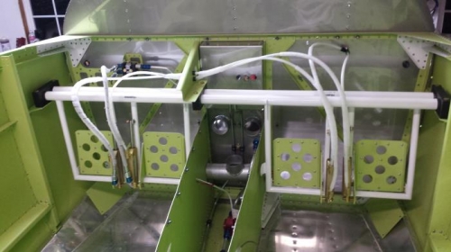

Brief Description:  brake lines
Installed the brake lines over the last few days. I used a heat gun to soften the nylon tubing as boiling water in my shop is a little hard to come by. I had to be careful not to overheat the tube. I used a bit of nylon spiral wrap to keep the lines from rubbing as the pedals move. I like the look of the after market SS braided lines, but can't justify the added expense just for looks.
