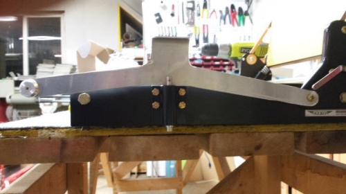

Brief Description:  modify seat mechanism
Today I added what I hope to be the last layer of micro to the canopy top.
I finished up reinstalling the micro connectors on the control sticks.
I installed the seat floors and seat rails.
My tech counselor has an RV-10. He recommended I make the seat adjustment mechanism accessible from the front of the seat. Rather than putting the original handle back on, I extended the leaver arm upwards and bent a curl to add a side handle capability. I turned the front handle on the lathe from 1" aluminum bar stock.
I need to make another one for the passenger side. Update; done in an hour now that I don't need to design the solution.
accessable from the front now
