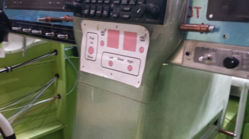

I needed to separate the upper section of the center stack from the lower section to allow maintenance access to the center tunnel. I also needed to redo the attach points for the upper section as what I had was far too weak to positively position the cut off part.

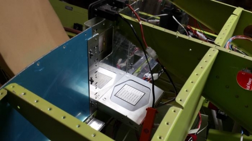

Once the cut section was firmly mounted in position, I mounted the first official piece of avionics. The Audio/Intercom system tray is in place.

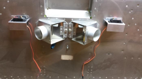

Next, I continued work on the heat control servo system by fabricating and attaching the mounts to the firewall. These will be controlled by the Aurduino and turn the heat on and off (left/right).

split off upper center stack
mount GMA 245 Audio Panel
heater inlet servos
heater inlet servos
