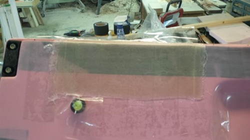

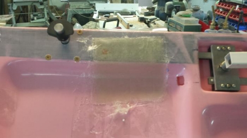

Brief Description:  fabricate door trim covers
I laid up covers for the hinges and the end of the rack that poked out into the arm recess.
I used the edge of the door as the mold excepting the hinge pocket that intersects the head recess. That cover needed to be molded in place.
After the glass cures, I will trim to size and add mounts.
glass for rack cover
glass for back hinges
glass for front cover
