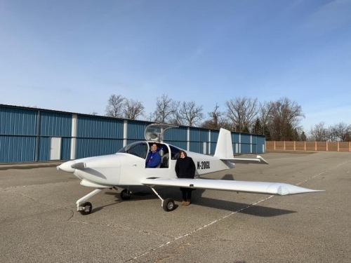

First flight was Jan 16, 2020 and other than very exciting, was fantastic. Full throttle, lift off, wiggle of the stick to confirm positive control, then up to 3000 ft to orbit above the field. Everything went red X after the 3rd orbit when the CAN went down, then mostly came back. I still had radio altitude and airspeed, so no issue returning to the runway. Wiggling things brought back the CAN. I didn’t actually find the problem until a later issue at around 35 hrs, since reseating the connectors resolved the issue for the moment giving me a false sense of finding the real problem.

first flight today
