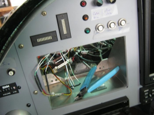

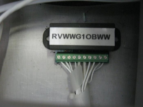

Problem: the pith trim is being indicated on the aileron indicator and the pitch is also reversed ( fwd push on hat switch moves the trom tab down and pitches nose up). Not correct! Im glad I made a rear access door to the instrument panel because this simplified the acces to the indicator wires that I had all zip tied out of the way. I cut the zip ties and then removed the engine monitor and then sat in my seat and cut the shrink tube that covered the wire pins. I simply swapped the three indicator wires from the two indicators ( 6 wires) and swapped them. Checked operation and then heat shrinked new shrink tube on to each connection, That got he pitch and roll trims indications on the correct indicators. Then I had to reverse the pitch trim so that the trim tab moved up when hat switch was pushed forward. This required removing the front seat, seat back, seat pan and then swapping the two white wires in the stick servo. Thjese are the last two wires and by simply unscrewing them and swapping and tighening back up solved the problem. I tested it and then installed everything back as it was..atleast with minamal screws for now.

Removed EMS and swapped the aileron and pitch servo indicator wires
Swapped the last two whire wires from the the pitch servo so as to reverse polarity in correct with sw
