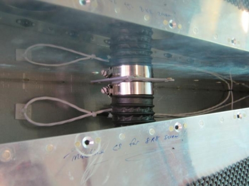

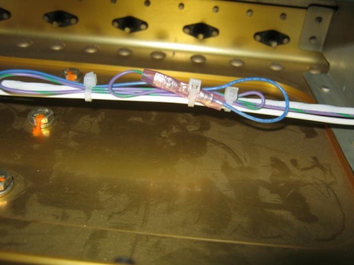

Pictures dont show the trouble I had with getting wires hooked together at root. The landing/taxi light wire from fuse was connectorizied prior to wing instal but I did not leave enough slack to get a crimper on it to do the wing wire end. Same deal as with the left side. I also had a hard time fishing my OAT wire (the blue one) Into the wing and down to the probe. Turned into a long dfficult process but I got it done. Connected the wires with butt splices and tied up The molex wire bundle from position light was easily connected and I secured to the root floor. Took up extra slack from wing end.
I know its not wire work but I also connected the rear fresh air scat hose to the fuselage flange and tightened down.
Strobe/position wire bundle rt side connectd and secured  in root. Fresh air scat attached
OAT probe wire connected and tied up slack
