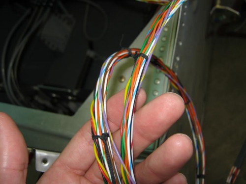

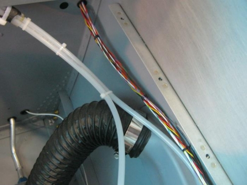

Brief Description:  Run required engine sensor wires forward
After Fished wire bundle from EMS into left gear tower and exit tower thru a predrilled hole on fwd gear tower face. There are 4 hles pre drilled there. I know that I need ! for throttle and one for the Mixture cables and so I determined which ones I will use for those. I decided on the outbd lower hole of the group and installed a snap bushing after makig sure the bundle will fit through it. The 4th hole will either be used for the cabin heat box flap or will be left open.
Fishing the bundle throu was the hard part but some spare safety wire helped greatly.
I ran the wire bundle along the baggage left angle support and will add adel clamps to the underside with couter sunk machine screws.
The wire bundle exits a prepunched hole in FW on left edge. I will try to make it work after I get some ordered hardware. If the hardware looks to be too tight, I will abandon this hole drill another one closer to where the CHT/EGTY wiring exits and then plug this hole
