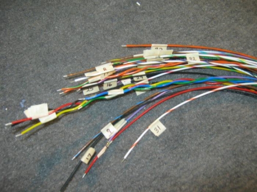

Continuity check and label of EMS wires
Checked each pin of the 37 pin harness for continuity and then labeled each wire with number that will ref the wire list in ems manual. This is temporary for set up.
