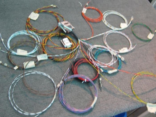

I needed to know what wireing from the EMS was needed forward of firewall and what wires will stay behind panel.
I first went thru all the wire and bundled into loops the wire groups. For example the fuel flow wires are 3 wires and so I bundled together and labeled with masking tape. I did this for all the wires.

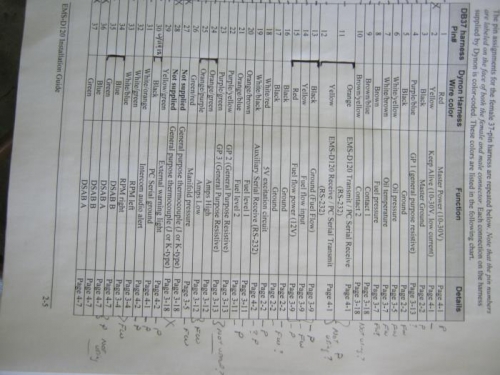

In then went thru the wire chart provided and labeled each wire for needing to go FWF for sensor connect or stay behind panel for connection.This took longer because I then went thru the install manual again to determine what sensors I have and to confirm how they are to be connected. So time spent reading.
I then realized that I needed to know what diameter hole I need for wires going forward. Cant exactly do that with all the separate loops! I gathered the wires going forward as per my notations from chart earlier and then undid the loops and gathered together. I left the wires for panel side in loops for now
Grouping EMS wires for function
Deciding and noting wires for panel and Firewall sides
