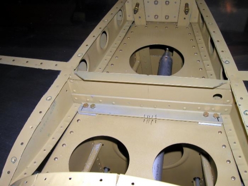

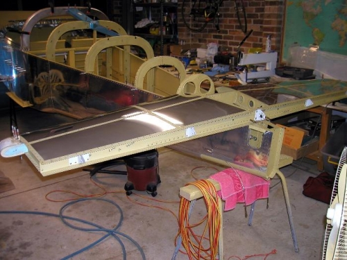

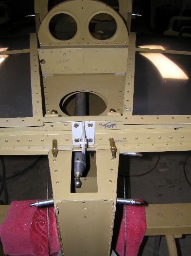

Drilled the horizontal stab
Tonight I drilled the forward and rear horizontal spars to the rear fuselage deck and uprights.
All the forward bolts have good edge distance and the rears are a no brainer as the uprights had been pre-drilled during construction.
Alignment is almost perfect with only 1mm difference measured from the stab tip to the firewall.
I am pretty pleased with how this has turned out.
Tommorrow night the Vertical Stab....
