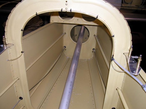

Today I removed the rear turtle deck skins and deburred and dimpled the rear most skin before etch priming.
Also riveted the remaining vertical sections of each former where I have left them open incase I wanted to remove the longerons. This took a couple of hours in itself. I also drilled and installed the triangle brackets that support the rear baggage former and the next former back from this.
With this done I installed and pulled through the static line to the forward cockpit area.
Static lines installed and pulled through to front of fuselage
