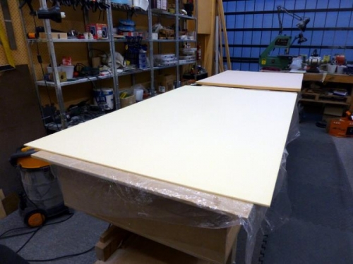

This was a days work cutting the CS spar foam. I'm using H35 Divinycell instead of urethane for the 1" pieces.

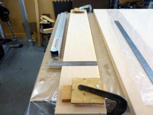

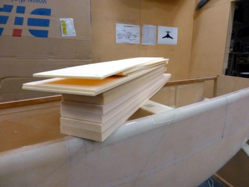

I was very particular getting the 1" pices the correct width, length can be adjusted later as I may need some mitred edges. The 1/4" foam I've really just roughed out and will get it exact in the jig. Seems an easier way.
Cutting the big sheets
Getting edges square
Roughed out and ready
