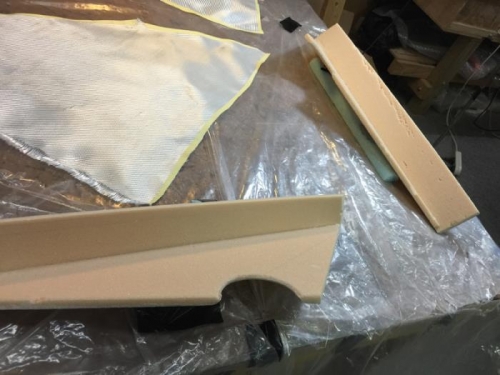

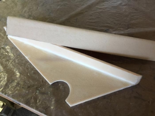

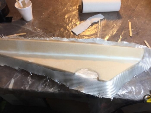

The insides of the rear consoles just need one ply of BID. As always prep takes a while, cutting the glass and getting the surfaces clean. Then the micro prep and I made a good transition on the inside with dry micro. Pic 3 is after the cure and a trim.
Insides done... move on to the next part.
