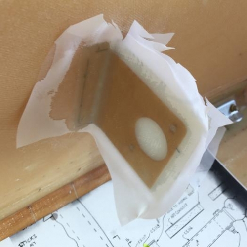

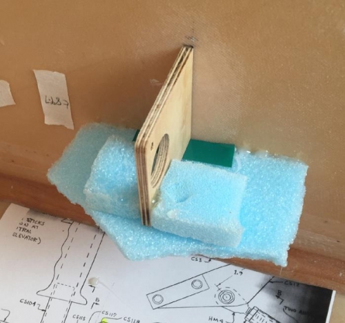

Rear stick time ....or CS118. As with the front, I used the foam shelf method to hold things in place. Again a 3 ply layup per side and then peel ply as you see in pic 2.

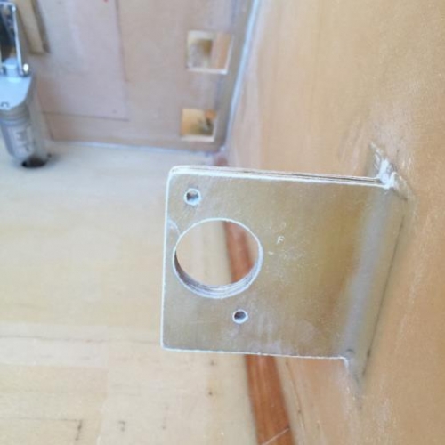

Pic 3 has the part all cleaned up. Very pretty. No one will see this when the plane is built. Yes I know the cut out is near the edge. When the arm rest is on it will be nice and strong and the rear stick will be in plans position.
Foam clamps
Foam clamps
Layup done
Layup done
Nice and clean
Nice and clean
