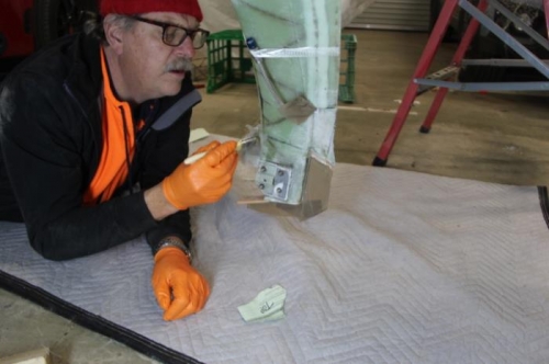

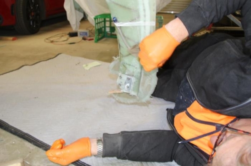

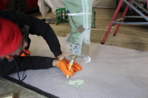

Brake fairings and heatshield
Inboard layup starboard side. Wet out 3 x BID on peel ply and transferred, overlapping gear let 1".
Bit #1
Bit #2
Bit #3
