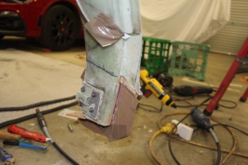

The prepare-for-a-flox-corner-with-bits-of-plastic worked so well with the previous bracket I did the same for the inboard side. Tape, hot glue blocks, bits of plastic. All lovely.
Preps for first heatshield layup

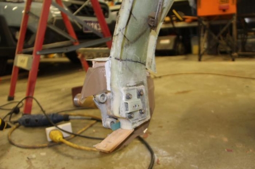

Brakeline taped out of the way, and base protected.
