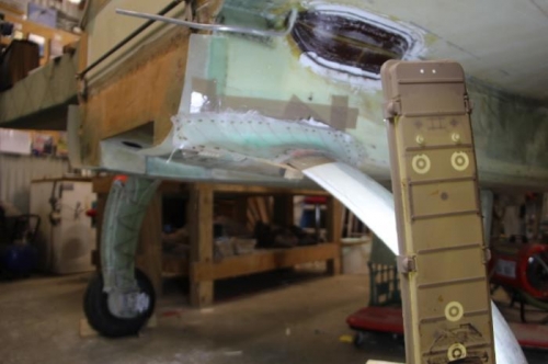

Brief Description:  Main gear fairings and heatshield
Over-trimmed starboard brake cover. Only occured to me afterward I can compare P/S easily by putting them face to face. Duh!

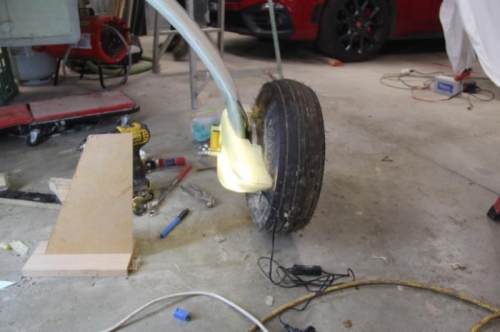

Cut slot for gear leg and rotor. Illuminate inside the cover with my LED strim, and drill pilot hole through bracket and fit cleco.
Confirm with arm-waving, measurement of the centerline to the floor and eyeball it is parallel to the port.
Hot glue on some bits of plastic and replaced 5 x BID over the overcut bit, and 3 x BID over the face mounting hole, like I did by accident on the port.
Put leftover resin into a fillet for the starboard side.
Drilling pilot holes with LED guidance
