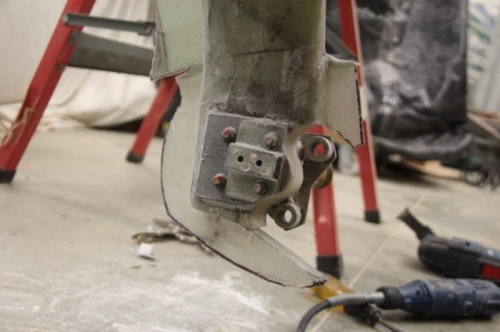

Filled the gap on the inboard gear fairing with modelling clay, with a 1/4" fillet to the cover.
Cut 4 x BID to a paper template, wet out on and transferred with peel ply, overlapping the cover and the taped gear leg by 1".

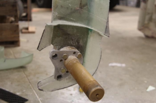

Been meaning to experiment with an upper gear fairing for a while. Most people attach the fairing to the fuselage side and the gear leg with the weight off it, then cut it. This makes it aerodynamic in flight, and allows the leg to flex on the ground, but leaves a visible gap and misalignment. I have been pondering a fairing that floats on the leg and side, and is held against the side by a spring, maybe to the gear tabs?
I put 3 layers of duct tape over the gear leg, and box taped the result and the side. I hot glued a bit of 3mm ply to form the trailing edge profile and taped it. I spread modelling clay into a fillet, smoothed to an even radius with a 1 1/2" plastic pipe forward, and extended into a pleasing shape aft. This is just the top half. I'll make another for the starboard side, and revisit the concept when the fuselage is inverted for finishing.
Wet out 4 x UND at 30 degrees fore and aft on peel ply and transferred to the fillet.

Heatshield bracket before outer skin
Inside, with cover mounting bracket
