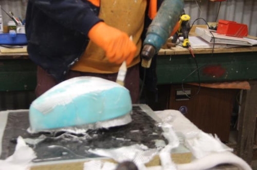

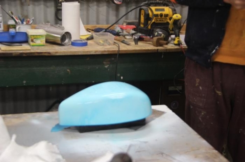

Over the last couple of days applied 3 coats of car wax, and 2 coats of mold release. Had some hideous runs on the mold release, but was amused the next day to see the excess had just dribbled off, leaving a lovely even finish.
Applied 4 x BID overall, with 1 x BID just over the face, with the aim that the overall thickness be even, with the edges bunched up as they do.
Waxed plug with mold release

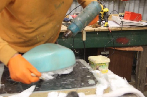

On with the BID. Cheating with the gun, it is freaking cold
Final ply
