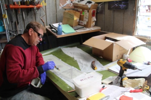

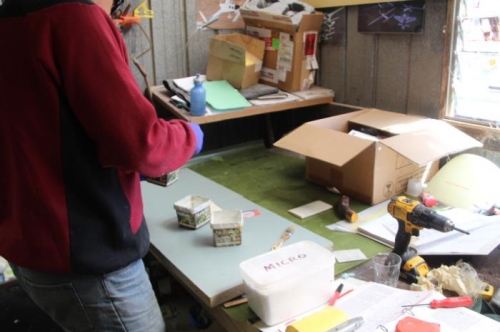

Layed up flange for MLG Outer Cover with 4 x BID. Usual method, wetted out tapes on peel ply, over plastic, and transferred to the work on the peel ply.
Peel plied edges, but could not be buggered with the transitions. Bit of an experiment.

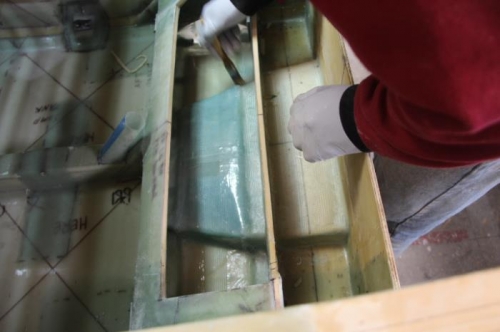

Had too much epoxy, so decided to layup the MLG Inner Covers. Used a technique I have read about after I did my last flay layup. Apply 2 x BID and peel ply, invert, then 2 x BID and peel ply the other side Did not log when I cut these out, and have forgotten, sometime in February?
Rather than using plastic have got some new 1.25" chipboard with melamine on it, and used these to weight the layup
Laying up flange
Laying up flange
Laying up Inner cover
