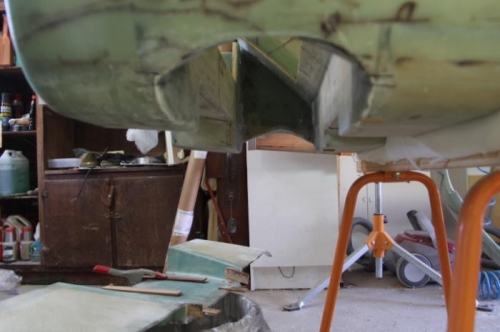

Brief Description:  MLG Outer Cover flange
Trimming is difficult with alignment sticks in place so knocked them off and trimmed it properly. While the sticks were off I taped up the inside of the Outer Cover properly, then I trimmed the NACA area first, then reapplied sticks in the NACA, then did the rest. Combination of clamps and clecos applied to hold them in position.

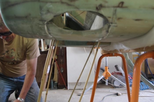

Clamped cover in position with bamboo sticks. When you place #2, #1 falls down. When you place #6, number #2 falls down. Endless fun.
After cure clamped up sides. Fell off again, started again...
Clamps, clecos, bamboo and a couple of tek screws got the job done.

Alignment sticks only in NACA
Bamboo clamps
Bamboo clamps
