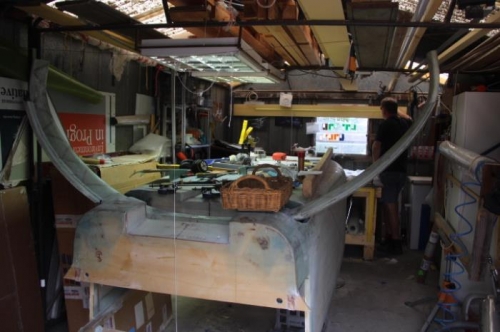

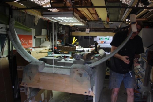

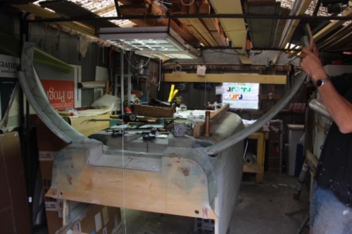

Brief Description:  MLG Axle install
Repositioned and re-bondo'd loose sawhorse legs and beefed up the others. Discover fuselage is now level, and marked axle locations are all as they should be. Feeling better about myself.
Nail a spare weatherboard to the wall, and use that for re-marking the centerline and toe-in sighting points.
Finished flatting PORT Axle mount.
Made a variety of jigs for installing the axle.
Marking sighting points
