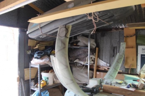

Marked up strut cutline for caliper clearance. Was a bit horrified at how much had to go, so went and ground more off the caliper lobes. Used point closest to locating pin as reference and ground a smooth curve around the lobe at this radius. Reasoning: if it is strong enough there, it will be strong enough all round. (Timewarp 25FEB15: When actually fitting caliper discovered clearance was fine at outboard side of caliper, but tapered outward along the edge. Had to grind away some more from the lobes, now parallel to travel along the locating pins.)
Did initial cut of strut. Jigsaw seemed to do the best job. Cleanup with multitool and sanding drum. Not ideal because of heat.
Another trial with the jigs. think I need a backing block for the backing plate...
Cutline. Alors!
