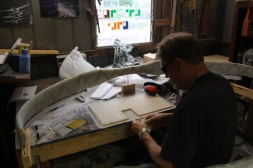

Prepared leading edge landing brake and marked reference points for mounting hinge.

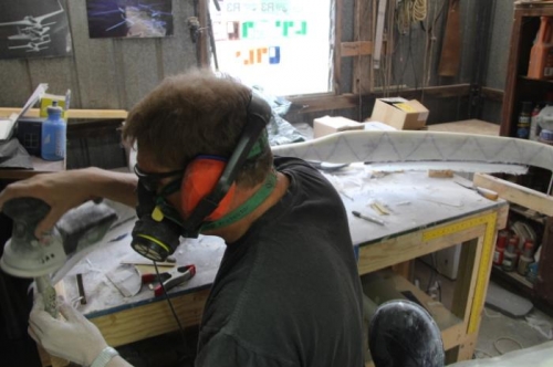

Sanded conduit layup. There are indeed air bubbles in the micro. Will try injecting micro slurry.
Inverted strut and sanded smooth transition to leading edge. Had to sand off most of the leading edge down to the strut, so I hope the 1/8" gap referred to in the FAQ is the bollocks I think it is. Plan to avoid one re-mounting of the MLG appears to have worked fine. Still got spectacularly itchy.

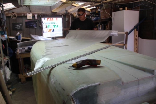

Cut three more 12" strips of UNI for the 2nd torsional layup
Prepping Landing Brake
Sanding MLG leading edge
Cutting more UNI
Cutting more UNI
