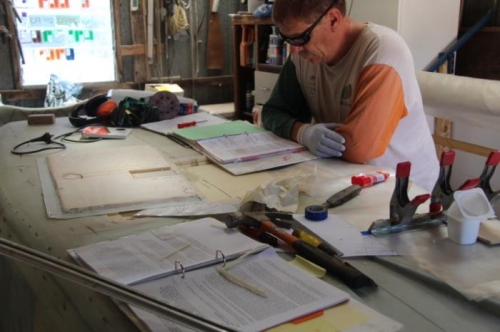

Finished prep on LB hinge. Assembled LB-19 to hinge and tacked to LB-23 with Al spacers in between.

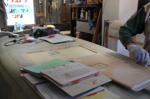

Trimmed Landing Brake, removed 3/4" of foam from LE, just realising it was in the way of the hinge.

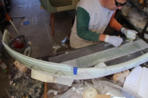

Used leftover micro to fill seatbelt outer holes and hard-shelled Landing Brake.
