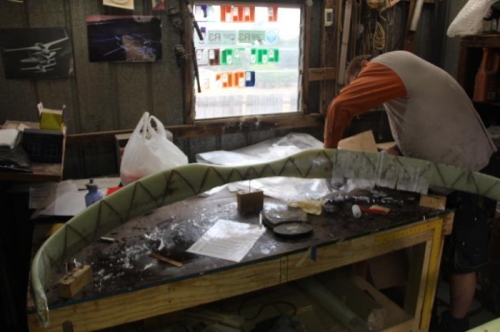

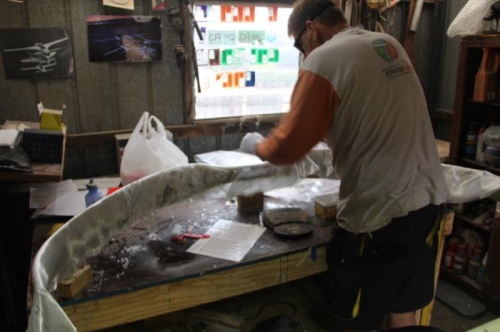

Brief Description:  !st torsional layup
Applied 1st torsional layup, 4 x UNI & peel ply all. Keeping the fibres straight was a bitch, but sliding the main fibres parallel worked, cross threads were all over the place. Constantly thought I had got it wrong, then realised I was looking at cross threads.
Applied peel ply cut into strips to follow the curve.
