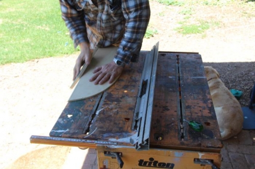

Cut LB-19 and LB-23 (12" long, due to LB-19 being outboard of plans location) on triton.
Cut AL slugs for LB-23, sanded, cleaned, alodined and primed (other than mounting surface). I'm going to do this for all aluminium parts, so from no on I'll only say "prepared". 5-min to LB-23, marking centers on drilling side.

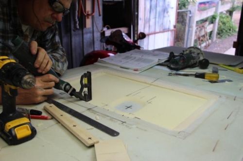

Prepared LB-18, slightly not as plans, adjusted holes to correct edge allowance, and for 1/4" hole for actuator.
Routed fus bottom for Landing Brake. Forgot plan to use travelling box and did edge with sandpaper and multi tool.
Routed hole for LB-23.
Removed foam for actuator slot, wider and shorter than plans.
Decided not to leave MG-2 with attachment pilot holes. Drilled out, reamed to 3/16" and countersunk
Cut shims for LB-24 hinge from 0.025" Al flashing.

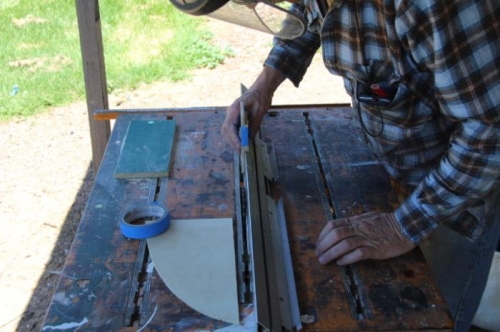

Cleaning up 45 degree bevel for LB-23/19
