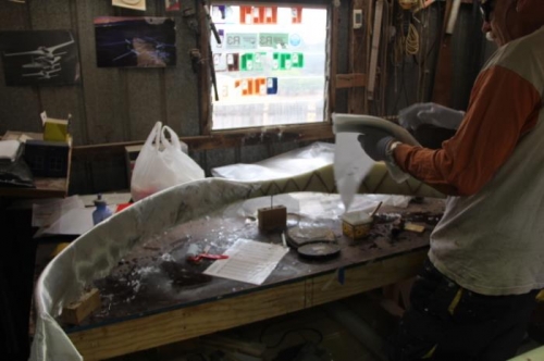

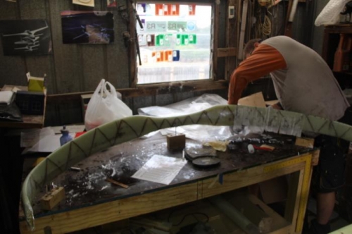

Brief Description:  1st torsional layup
First layup in quite a while. 4 x UNI @ 35 degrees and peel ply all. Had to fart around a lot to get the fibres straight, was able to follow the shape of the strut by sliding the heavy fibres longitudinally. They are straight, but the thin fibres are all over the place.
To follow the curve cut the peel ply in alternating strips.
Slapping on UNI
Slapping on UNI
Peel ply
Peel ply
