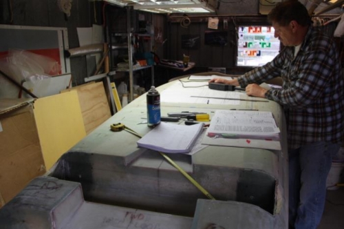

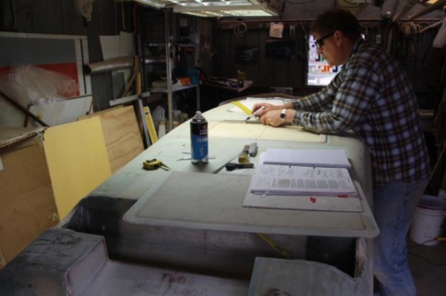

Marked Hinge line for Landing Brake. Found the plans method of drilling up from the leading corner of the seatback difficult. Had to fart around with a cardboard template to get the 6" either side of the centerline working over the heat duct, and couldn't get a vertical hole. After cutting a heap of mess the result coincided with the line I'd drawn in CH06. Complete WOFTAM.

Marking the Landing Brake hinge line
