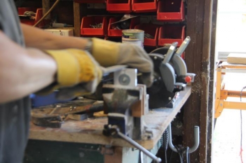

Cut MG-1 and MG-2. Drilled and reamed center pilot hole. Drilled attachment pilot holes on MG-2. Marked each pair of MG-1 and 2 with part number and N, S, E & W to indicate which is a pair, and will mark fus to match.

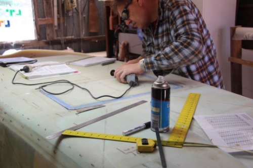

Marked and started to cut out Landing Brake. Plans hacksaw blade and razor saw useless, did reasonable job with dremel and cutting blade. Why didn't I use the frikken multi-tool???
Discovered Landing Brake is too short by 1/2". I marked the 14" called out in CH07 including the hinge extension, should have been along the edge, not including it. As the forward line is 1" aft of plans, this means the aft edge is now 1/2" aft of the plans location. May be a good thing. I have short-changed my Landing Brake by 3% of its surface area, but I will proceed as is.
Filing an MG-2 to MDF profile
Cutting out Landing Brake
