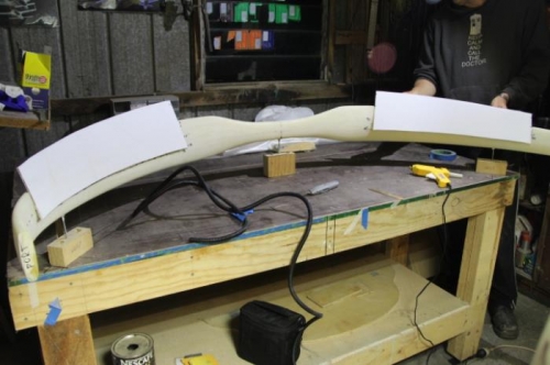

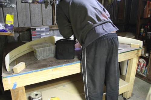

Brief Description:  MLG strut preparation
Joined tables side-by-side and levelled with threaded rod and levelling blocks.
Screwed stand-off blocks to bench, added some long 10g screws, roughed them up and 5-min flox'd MLG strut on LE down. Seemed to work easiest to prop it in position, lift the strut at each point and butter some 5-min flox on, and leave a little while before playing with it.
Tried hot glueing the coreflute backups for the fairings, worked OK, but they have to come off as the first torsional layup comes first.
Mounting the standoff blocks
Hot glueing the BID backups temporarily
