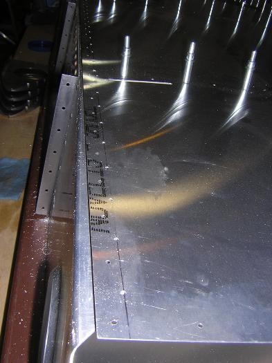

1. Put a plywood strip in place to protect the bottom of the main spar, and drill a new line of pilot holes, 3/32". See Fig. 1.

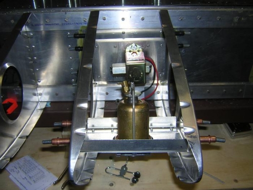

4. Position and drill #30 the gascolator mounting channel between nose ribs 2 & 3. See Fig. 2.

New line of pilot holes for spar
Gascolator mounting channel (upside down)
