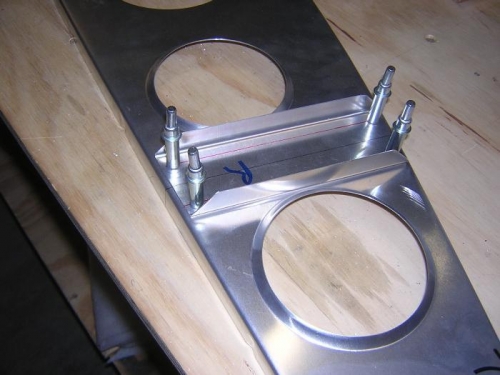

Brief Description:  Drill & cleco bell crank support channel
1. Draw a line down the middle of the bellcrank support channels, 6W6-10, and a line equidistant between the pilot holes for the channel on the rear ribs #7.
2. Position the bell crank support channels on the ribs(L&R), aligning the channel center lines with the line on the ribs; mark the edges of the flanges at each end of the channel.
3. Draw lines 4-mm from and parallel to the flange edge lines on each end of each channel.
4. Trim each channel end with snips and file smooth. Trim flange ends to 45°,
5. Clamp each channel to its rib & back-drill & cleco 3/32" through the pilot holes in the rbs. See Fig. 1.

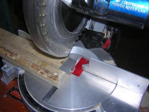

6. Use chop saw to cut the flanges on the aileron bellcrank supports to the required 20-mm width. See Fig. 2. I screwed the supports to a scrap 2x4 to immobilize the support while sawing. I should have used the chop saw to make the other cuts on the supports. It is much easier, once one provides adequate support.
