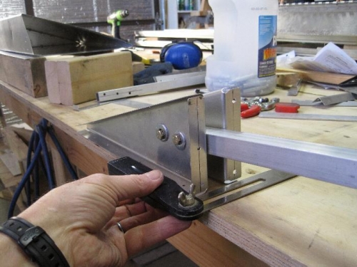

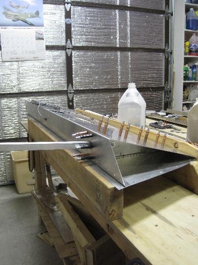

11) Cleco the inboard rib to the aileron, bolt on the balance arm and outboard rib
12) Pilot drill the outboard rib to the aileron skin, top and bottom. Then drill the front, using the existing #20 holes as the pattern. Fig. 3 shows the balance arm.

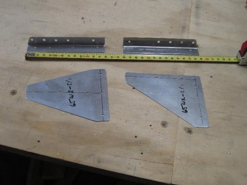

13) Cut, fit, and drill the L-angle horn reinforcement to the inside of the inboard rib.

15) Drill the two gusset for the inboard two ribs. Fig. 3 shows the gussets and horn reinforcements.
15) Cut the L-angle servo mount doublers, clamp and drill into place.
R Aileron counter-balance arm & ribs
Aileron with balance arm clecoed in place
Gussets and horn reinforcments
