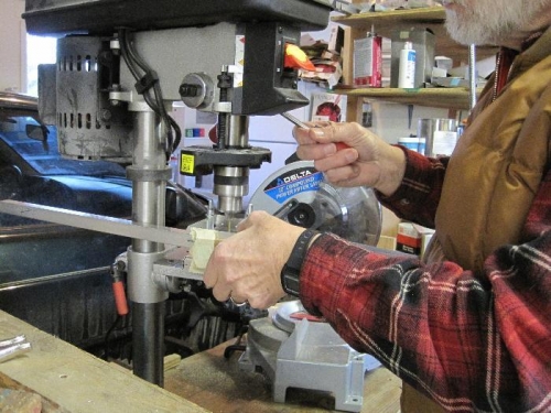

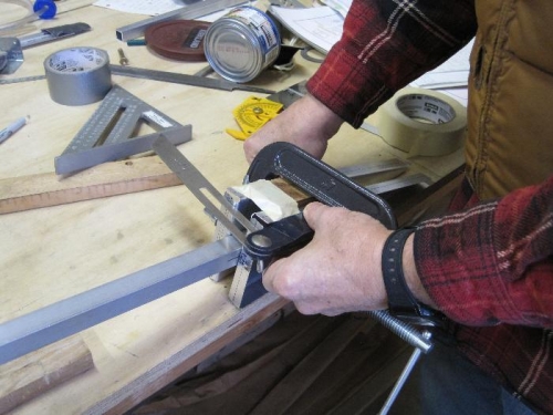

4. (cont.) Accordingly, after making sure sure that the bend angle on the front flange of the ribs were adjusted to match the rib angle with the front of the aileron, I used an adjustable square to align the rib front angles to the same angle, as shown in Fig. 1. Then I clamped the ribs in place, being careful to keep the ribs perpendicular to the table top. Finally I drilled the holes through both sides of the arm and the outboard rib on the drill press, clecoing as I went along, as shown in Fig. 2. Then I enlarged the holes to 1/8" clecoing both ribs as I went along. Finally, I enlarged the holes to 3/16" inserting AN3 bolts as I went along.

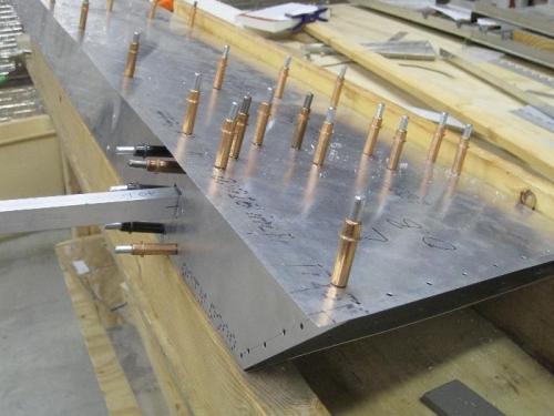

6. Finally, I clecoed the aileron back together, including the inboard balance arm aileron maintaining the wash out angle with a 13-mm block. Then I drilled the outboard aileron, top, front, and bottom, 3/32, 1/8, and #30, clecoing as I went along. It all looks nice and tight, as shown in Fig. 3.
Rib alignment as done
Drilling holes through balance arm
Balance arm bolted & clecoed in place
