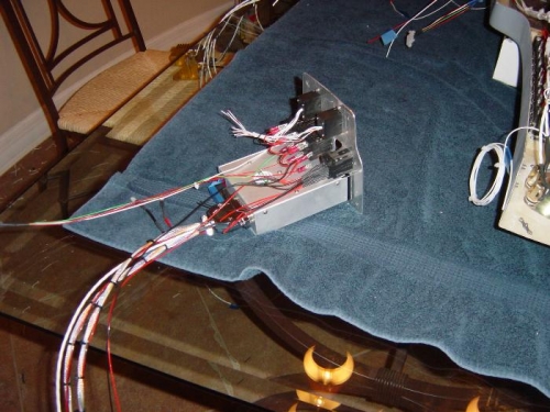

Replaced all of the Fast-ons with correct size

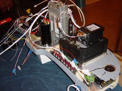

This side of th epanel is getting more tidy

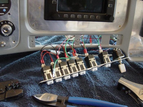

Replaced Fast-ons on center console switches (still 1 switch short)
