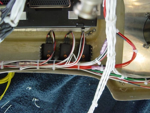

Brief Description:  Install dimmer switches and circuits. Continue on

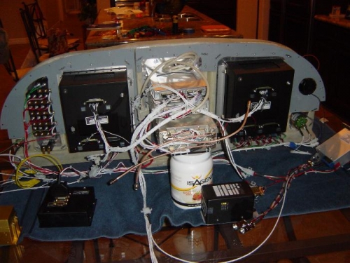

Began today by physically mounting the 3 dimmer switches for panel lighting. Then wired the left to controll the compass, clock, radios, and switch lights, Fabricated all of the harnesses w/ disconnects between the main panel and the center console. "Cleaned up' a lot of the other loose wires and tidied them into an existing bundle. the back of the panel is starting to look a little 'neater' is such a term is possible. I still have 1 persietent problem to trouble shoot tomorrow, and that is an intermittant error flag mesage that is persistent on the MFD display the error reffers to an RS 232 communication problem with the MFD display. I need to recheck some wires in the am as the console switch lights are not working. A lot of time for what doesn;t sound like a lot of work.
Panel light dimmer switches and wiring
Rear view getting 'cleaner'
Powered back up
Powered back up
