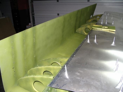

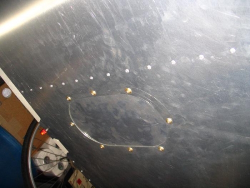

Brief Description:  Completed 1st access cover and opened right wing
In addition to a bunch of research (not included in today's time), I was able to complete my first access cover. Setting the nutplates with a borrowed rivet gun was a snap, and the results were good. The last time I worked on the right wing, I only pre-drilled the top skin to size #40. Before going ahead with the fuel tank installation, I drilled the spar line rivet hole to #20 and the nose ribs to #30. While it was still closed, I extended the rivet line for the new rib 4(A) on both the top and bottom. After drilling those to #40, I opened the wing to be ready to install the nose rib angle and nose rib.
Right wing with pre-drilled holes for new rib
Left wing aileron access cover installed
