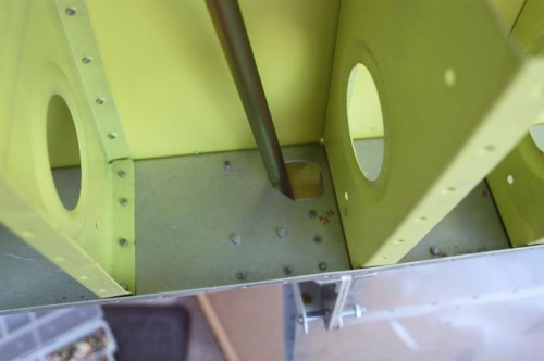

In the years since the left slow build wing was done, I decided I liked the white epoxy primer and so we have one wing in yellow etch primer and the rest of the aircraft will be in white primer. Used the dremel cut off wheel to remove the excess rear spar material outboard of the most outboard rib. Then, the outboard aileron hinge bracket can nest right up to the end of the rib and rear spar for riveting. Since the top skin was already riveted on, I slightly tucked a hack saw blade between the top wing skin overhang and the rear spar to protect the wing skin from the dremel wheel. When that wheel hits the hack saw blade, sparks fly and I know to proceed very very slowly to finish the cut. Then I filed the rear spar up and down until the file also started removing the yellow rib primer. That told me I had a perfect 90 degree area for a flush fit to the bracket that gets riveted there. I'll reprime that area before fitting and riveting the bracket. Also, I rasped out the rear spar hole to allow full movement of the aileron connecting rod as I make final adjustments.

Cut access hole for aileron bellcrank connecting rod.
